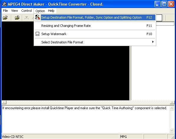

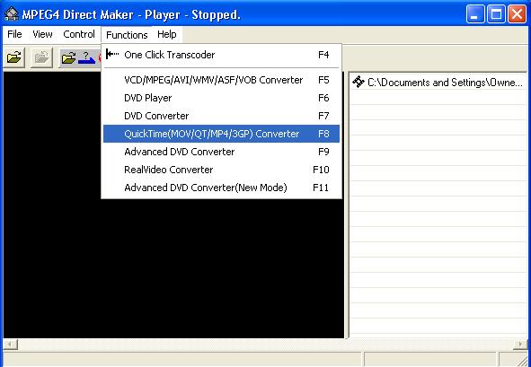

    I bought my v550 on sale for $289.00 same price that i could have bought the v530. V550 has 3x optical zoom a 2.5" lcd screen AND a viewfinder.
    now MPEG4 direct maker can turn your Apple quicktime into dvd format....
    May 2003
    Upstate South Carolina

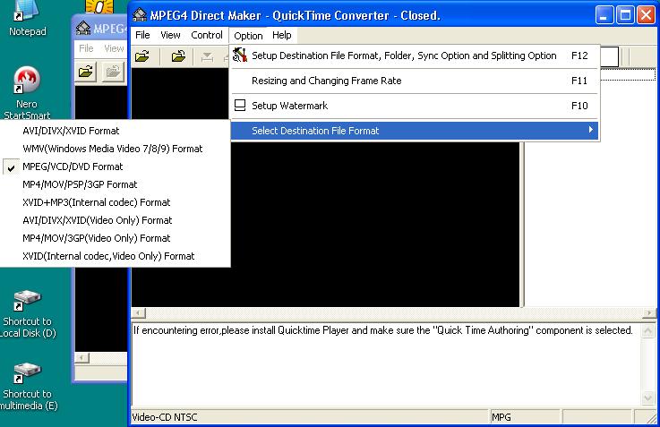

    after you pick the converter then you select the file output format...
    May 2003

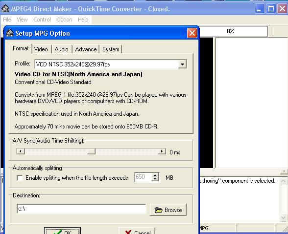

    now lets pick the settings of the dvd file...
    May 2003

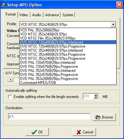

    And finally the many dvd file format profiles....
