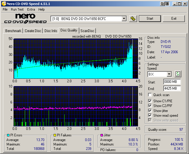

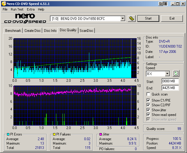

There was only one TY 8x spd disc that burned at 4x spd which was with my BENQ 1650 drive.Originally Posted by hech54
Both were burned & scanned with 1650.
1. SONY TY DVD-R 8x:
2. SONY TY DVD+R 8x:
