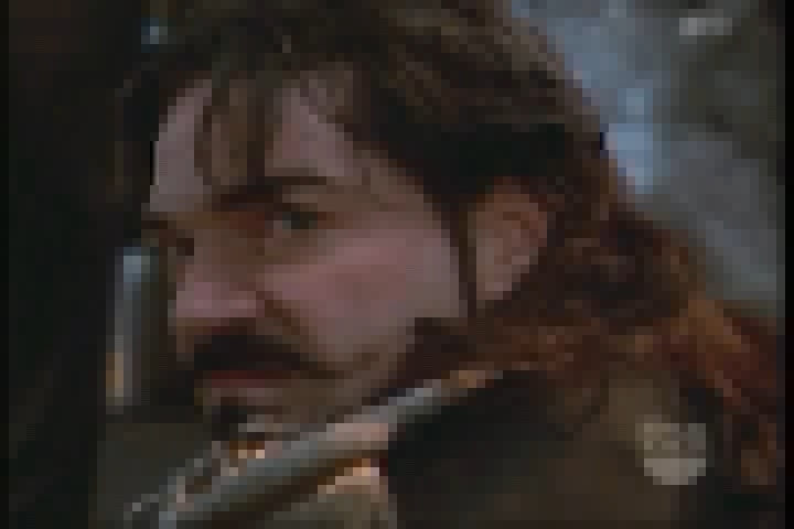

Here's an example of a capture with my PVR-250 set to 720x480, 800 kbps:

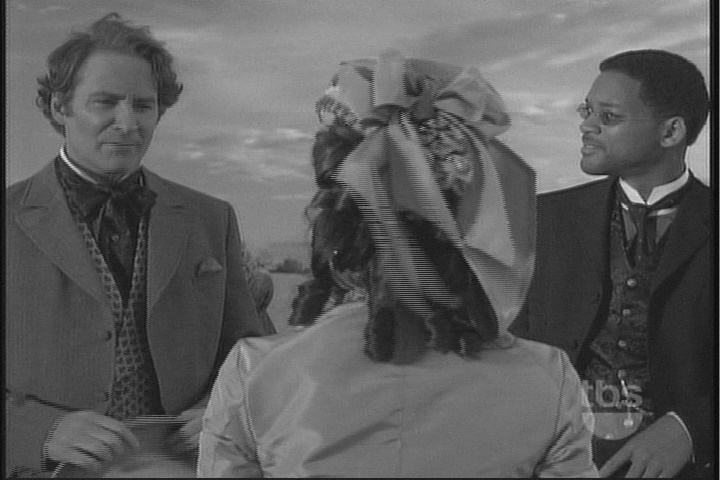

Here's the luminace channel from a capture from using GraphEdt from the preview pin (without changing any settings):
WinTV2000 with the PVR-250 can only do one or the other at a time. It displays the uncompressed NV12 data when it's not recording. When it is recording it decompresses the MPEG stream and displays that.
