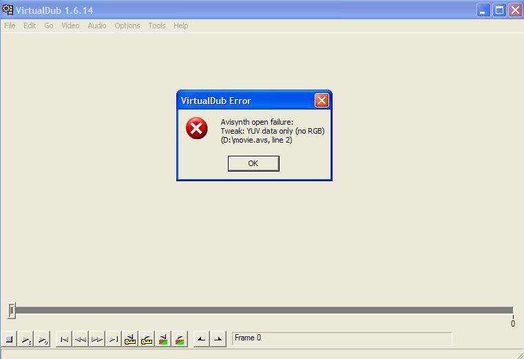

  1. I tried to open a movie using this script below with VirtualDub
    AviSource("D:\The Never Ending Story2.avi")
    Tweak(Bright=10)
    but i get this error up in VirtualDub have i done script wrong then
    Apr 2004
    Miskatonic U
    Looks like Tweak expects YUV colourspace. Try adding ConvertToYUV() before Tweak.
    Read my blog here.

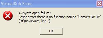

  3. I changed script to below as you said guns1inger
    ConvertToYUV()Tweak(Bright=10)
    but now I get this error
  4. He means ConvertToYUY2(). Or you can also ConvertToYV12() if you prefer.
    It's nothing you couldn't have figured out yourself:
    http://www.avisynth.org/Convert

    Looks like you missed a '.' and bad function name, in that script
    your source:
    note, there is no AVIsynth function called ConvertToYUV() that I know of.
    This is what is generating the error.. that, and the missing '.' inside
    your script, above.
    correctd source:
    ConvertToYUY2().Tweak(Bright=10)
    ..should open your video source, now.
