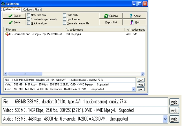

I have a video clip which i have run through AVIcodec and it tells me it is Xvid=mpeg4. I need to convert it to mpeg2 so i can use it with DVDlab. I've tried TMPGenc DVD souce creator but it always wants to resize it and the end result always seems to give poorer results than the original video. There is also an issue with the audio being 6 channel or something, it only played on Videolan VLC player for me, the conversion worked though. So if anyone knows of a tool out there that will convert this Xvid video clip to a format that will work with dvdlab and wont sacrifice any quality i'd much appresiate it. Also i have included some screenshots of AVIcodecs results if this helps.

For your video to be dvd-compliant, it must be 720 x 576, 704 x 576, 352 x 576 or 352 x 288 for PAL. You can either resize up or down to one of these or alternatively pad the borders out with black, such that the viewable area will not change but overall your video is one of these frame sizes.
Your audio problem is that you don't have an AC3 codec installed. If you wish to keep the AC3, the easiest way is probably to demux the AC3 stream (virtualdubmod or AVIDemux should be able to do this for you), encode Video Only and then import your M2V file and the demuxed AC3 file into dvdlab.If in doubt, Google it. -
