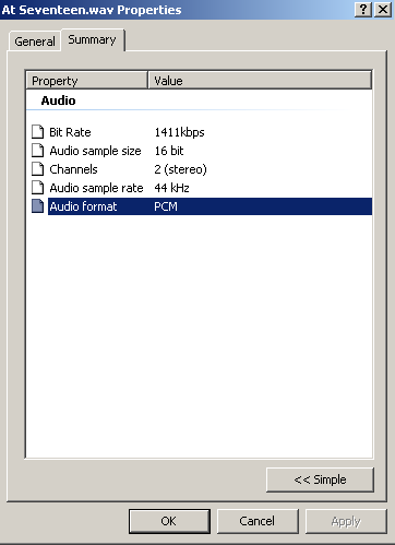

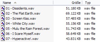

  10. To check properties:right-click on file and go to Properties->Summary->Advanced:
    Also go to Explore->Tools->Folder Options and untick "Hide extensions...." :
    BTW.. Audacity is what I would use to combine.

    Well I am just going on what windows tells me:
    Wave "sound" doesn't look right...the properties of a .wav file
    in Windows says exactly that....".wav file"....not Wave Sound.
