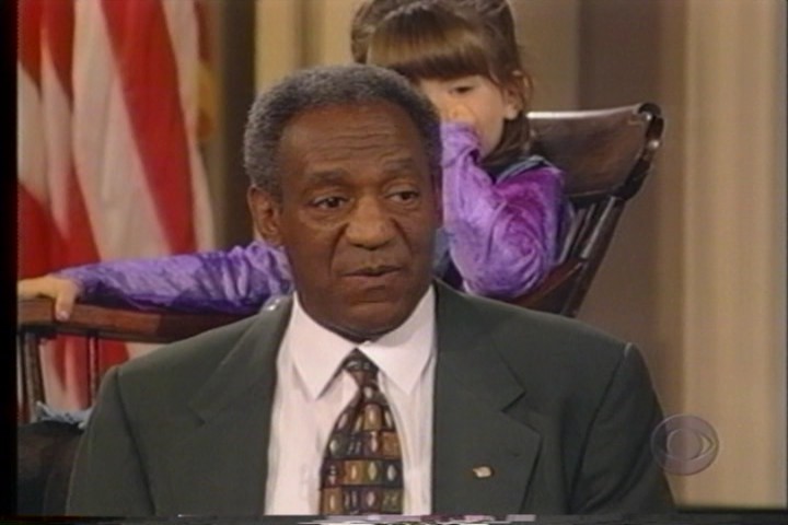

Image below was made on JVC DR-M10 from SuperBeta tape (VHS tape won't look quite as clear but this will give you an idea of the quality you can get from a JVC recorder).
