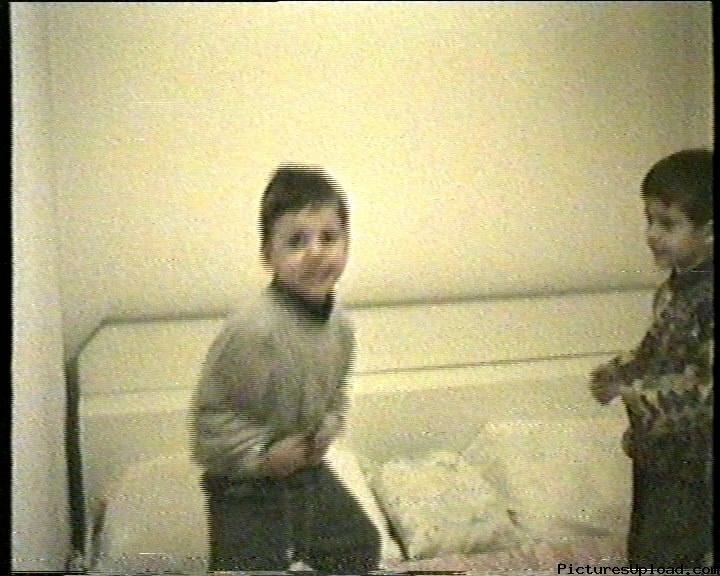

I have Canopus 110 and i am disappointed about analog (VHS) capture. Because i have always noisy capture even i have a good VHS cassete.
So i would like that everyone who have Canopus 110,100 and 300 upload an image.
2. Users who have Canopus 300 can say about noise reduction feature.
I am interesting thas noise reduction on canopus 300 is worth?
This picture is DV format (vhs).

Not really, no. The Canopus products are about 75% hype and marketing bullshit, and about 25% reality. Now, that 25% reality is generally pretty good, but they blow far too much smoke up customer's asses for my taste. I prefer a little more realism, and a little less waves of the magic wand. These are simple DV AVI capture devices, nothing more. They are not super-mega-special gifts from hyper-advanced space aliens.
There are colorspace issues when dealing with VHS and DV, something most people either do not understand, or choose to ignore.
Now, on the other hand, VHS is a lossy format. And your video appears to be underexposed, which would explain the grain. Add to that the fact that the computer monitor is higher resolution than a tv set, and you can see more flaws.
What you have here can be filtered in VirtualDub. That would be my suggestion. You pretty much have to filter most video anyway, when VHS is the source.
But no, that ADVC-300 will only bilk you for hundreds of dollars and give little in return. There are several DVD recorders that can actually clean up noise much better than a Canopus DV device could ever do for a VHS tape (JVC DVD recorders, plus a few others).Want my help? Ask here! (not via PM!)

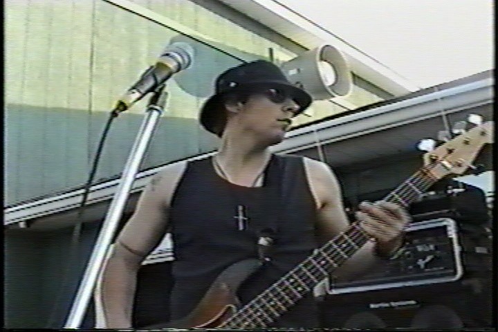

Stills don't mean much, but this is one I did just the other day. The tape is around 8 years old, and I've just got a standard LG 4-head VHS VCR straight into the ADVC-100. It's CDVC (canopus compatible) DV-AVI via scenalyzerlive.If in doubt, Google it. -

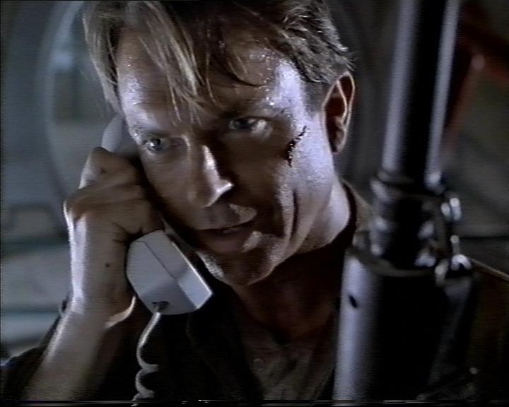

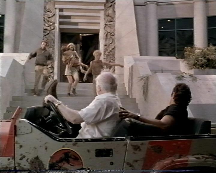

jurasic park vhs tape
Jvc hrs7700>tbc 1000>ati via svhs cable>virtualdub(mjpg)>powerdvd(screenshoot)

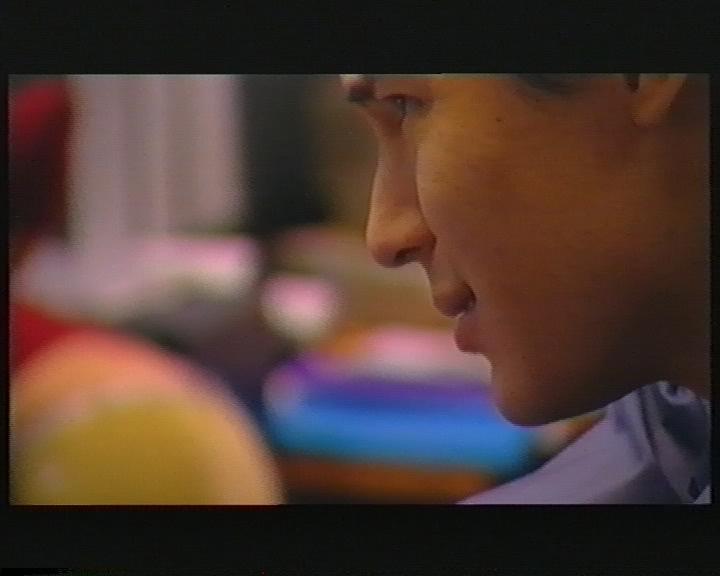

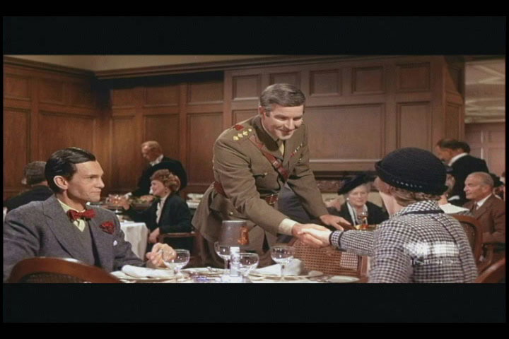

This is a 480i SD DTV source through Motorola DCT6200 cable box then S-Video to ADVC-100 480i.

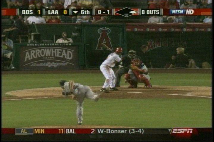

1080i HD 2.35:1 film through DCT6200 cable box then letterboxed S-Video to ADVC-100 480i.
1080i HD broadcast through DCT6200 cable box then S-Video to ADVC-100 480i.

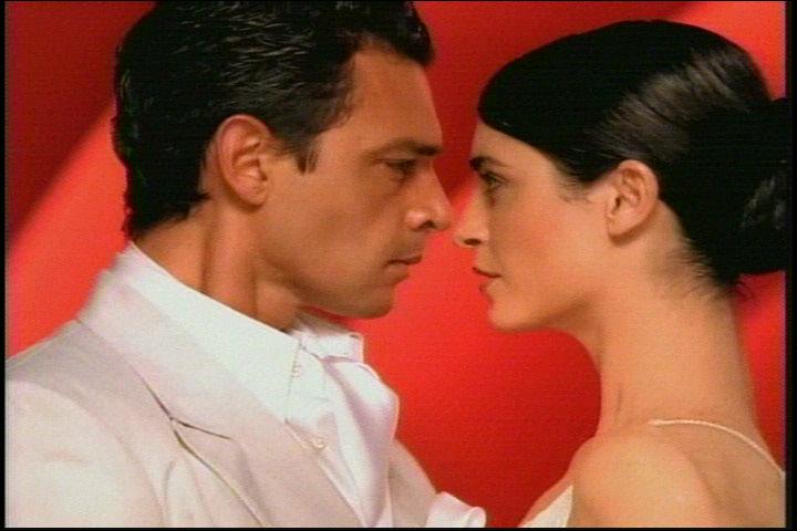

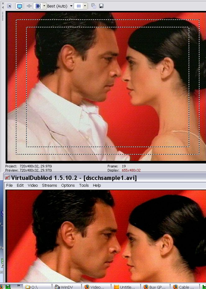

Look at the red background. It is not a smooth gradient and is "noisy" which is easily seen frame to frame. This is exactly what I get with my ADVC-300 and VHS tapes. That's why I use Convolution3D to smooth out the colors.. Unfortunately it is a time-consuming process.

Am I imagining or is the Vega preview less noisy than VirtualDubMod?

Do you mean the red diagonals? I frame selected for those. We have a whole thread on that as I recall. Remember this is a noisy NTSC analog cable channel.Originally Posted by Wile_E

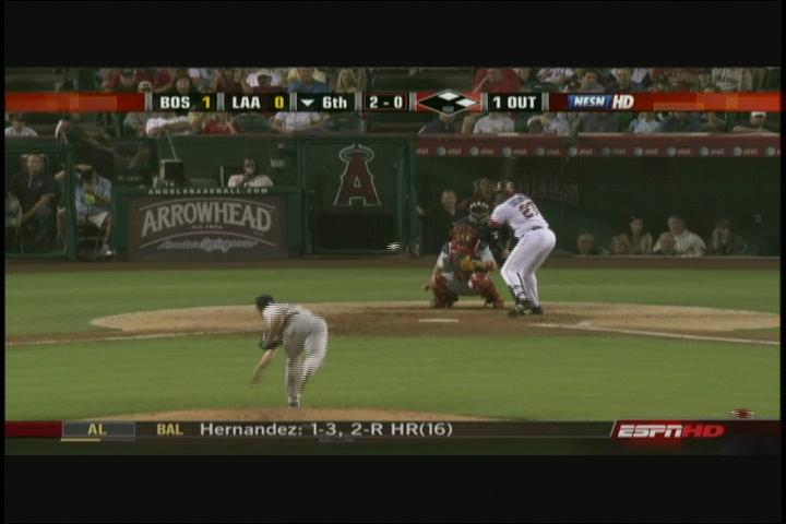

OK - 480i sports
First is ESPN analog channel over cable S-Video to ADVC-100 to DV 480i.
file
edpn-ntsc7.avi -
Next is same game ESPN-HD channel letterbox over cable S-Video out to ADVC-100 to DV 480i.
file
espn-hd.avi
