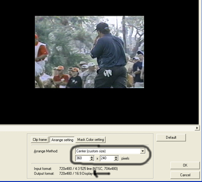

Here's a shot of tmpgenc in the clip frame mode - choose arrange method:
The simplest way I found was to simply cut the height and width in half. That way you preserve the ratio but turn it into suedo widescreen. And the best part is you can tell tmpgenc to output to 16:9 if you wish. I'm sure there are more technical routes to take but assuming the dvd cutscenes are 720x480 in 4:3 then just do this simple conversion and you should get something rather decent though smaller of course.Donatello - The Shredder? Michelangelo - Maybe all that hardware is for making coleslaw?
