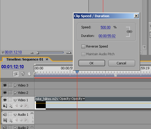

    In Premiere Pro:
    Make the cuts in the clip you want to speed up or slow down. You can use "Control + K" to make the cuts in the timeline. Right-Click on the clip and choose "Speed - Duration" and enter 500 % or whatever you want to change it to, like the following example:
    This will work and achieve one kind of effect - the speed of motion (walking, in this case) would jump from 100% to 500% with no "in between" speeds over a defined period of time. If this is what's wanted, then that's fine. However...
    I don't know Vegas, but it sounds like the "Velocity Envelope" achieves a different effect - i.e. start at 100% and accelerate to 500% over X frames or Y seconds. Can this be done in Premiere Pro?
