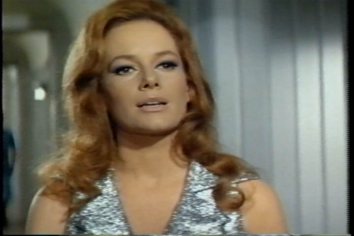

    I was fooling around with an old NTSC movie I dubbed onto DVD via my Pioneer 530. I made a .d2v file with DGIndex & loaded it into Avisynth with this script:
    LoadPlugin("C:\Program Files\AviSynth 2.5\plugins\DGDecode.dll")
    LoadPlugin("C:\Program Files\AviSynth 2.5\plugins\Decomb521.dll")
    LoadPlugin("C:\Program Files\AviSynth 2.5\plugins\degrainmedian.dll")
    LoadPlugin("C:\Program Files\AviSynth 2.5\plugins\fft3dfilter.dll")
    LoadPlugin("C:\Program Files\AviSynth 2.5\plugins\RemoveGrainSSE2.dll")
    LoadPlugin("C:\Program Files\AviSynth 2.5\plugins\MaskTools.dll")
    LoadPlugin("C:\Program Files\AviSynth 2.5\plugins\warpsharp.dll")
    Import("C:\Program Files\AviSynth 2.5\plugins\LimitedSharpenFaster.avsi")
    MPEG2Source("C:\Documents and Settings\~\GREENSLIME.d2v")
    Telecide(order=1,guide=1)
    Decimate()
    DeGrainMedian(limitY=5,limitUV=10,mode=2)
    FFT3dFilter(sigma=1.5,bt=4,sharpen=1.0)
    LimitedSharpenFaster()
    I used Quenc to reencode, thus keeping it all purely in the YV12 colour-space. It took ages, but there's a noticeable improvement in picture quality.
    Before Avisynth:
    After Avisynth:
