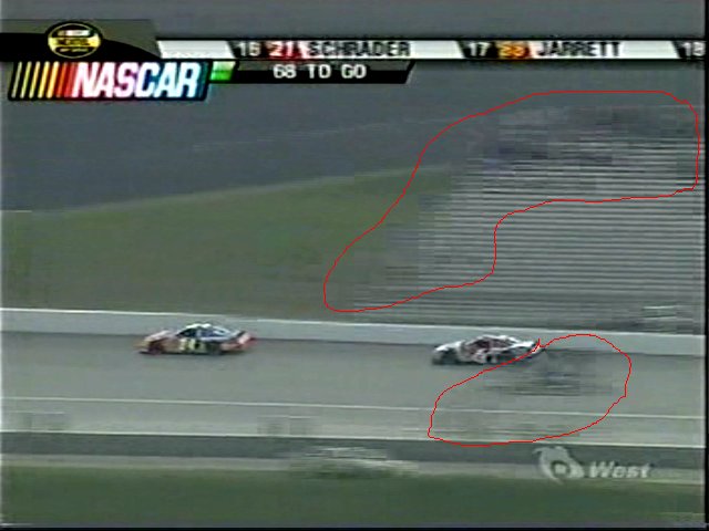

  2. By breaking up do you mean as in the image below in the areas circled in red? If yes, that is macroblocking. It is the result of the low bitrate used in LP mode. I pulled the image from another thread which was a discussion about a different brand of recorder but it was a good example of macroblocking in a fast action scene.
    macroblocking.
    No - much worse.
    Also the sound will go funny.
    Plus the picture will freeze for a few seconds (the time
    display will also stop) and then resume. This will happen
    many times.

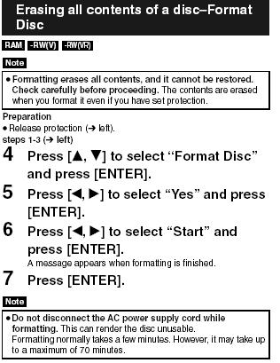

  13. Originally Posted by trhouse
    The ES10 has no quick or full erase.
    On Page 30 of the Panasonic DMR-ES10 owners manual, it tells you how to format the DVD-RAM disc. It would probably be better to format these discs on the DMR-ES10 rather than on a computer, because of the possibility of different format specs.
