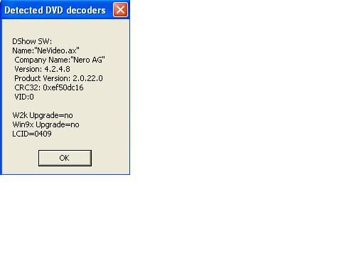

go to start menu -> run and run this (without the quotes) "dvdupgrd.exe /detect" and report what it says
dont delete mpeg2data.ax , but nero is what is doing your dvd decoding (so says windows)

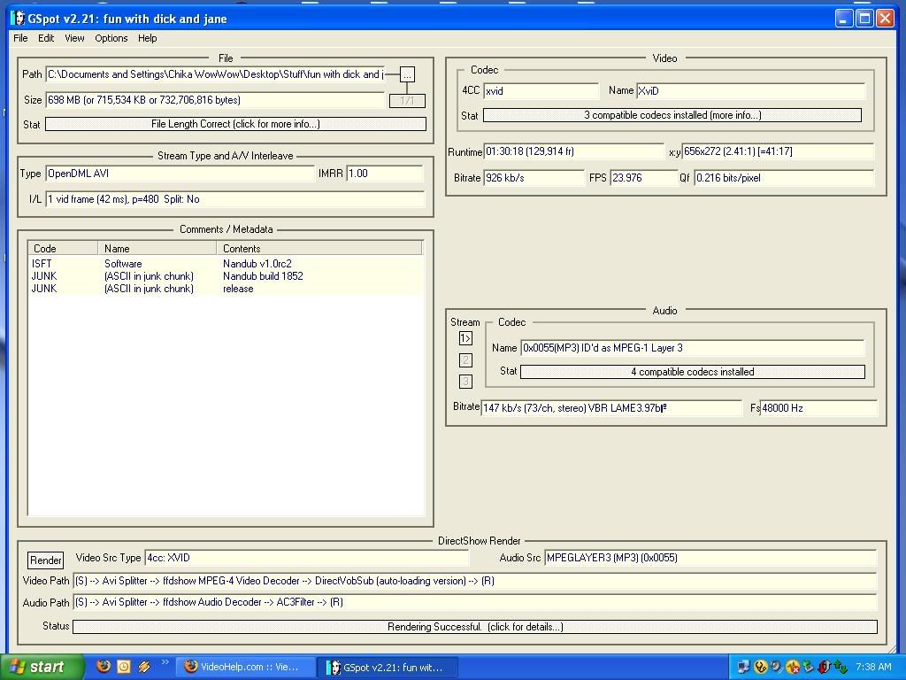

as for your issue with xvid -- in gspot , have you tried to play xvid in gspot and see what it reports ? if it can render xvid and show no errors , you might want to look at your install of vdub and/or where the xvid codec is installed -- i.e. in system directory and you dont have read permissions or not logged in as admin ..."Each problem that I solved became a rule which served afterwards to solve other problems." - Rene Descartes (1596-1650) -

I've opened an avi in gspot. The screen is here.
The avi's play fine in each player. They just wont open in vdub or avi fix progs. I still get the errors listed above ^^
