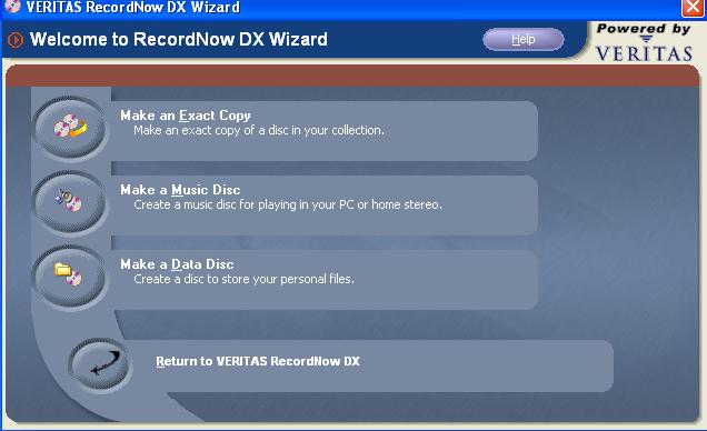

I know what you mean. I had Nero 6 last year on this computer along with DVD Decrypter and Veritas RecordNow ( now Sonic ) which is very similar to Neroexpress. Thinking that Neroexpress would be newer and better, I started using it and found that when I tried to make an exact copy it sometimes would refuse, but the old RecordNow would never fail to do it with exactly the same disks.Originally Posted by terrypin
I removed Nero and am continuing to use RecordNow for exact copies or I use a Pioneer 531H hard drive recorder which can also make exact copies of non-copyrighted material. -
