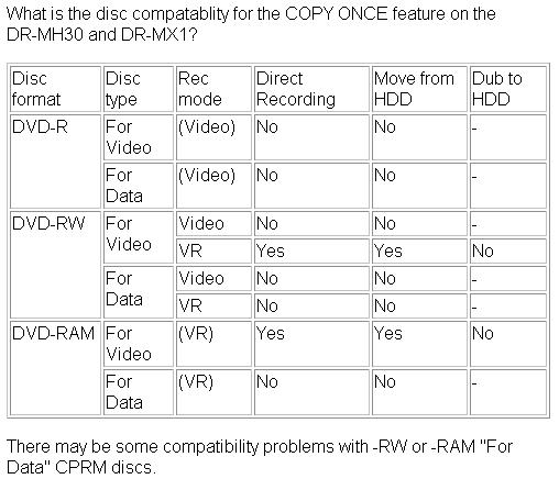

I cannot name any current production recorder capable of avoiding CPRM if that is the protection to which you refer. Here is what the JVC web site says about the ability of the MH30 ( which I believe is the same generation as the M10S ) and CPRM.yes but wil this new model have the copy protection problems most newer models have now. including toshibas problem with comcast pvr's?????

Maybe some of these references will help regarding CPRM. Yes, CPRM compatible means it is CPRM compliant and will respond to flags set in the broadcast, but it does not necessarily mean you cannot copy it.What do you mean they are cprm "compatible". does that mean they will not record a show if it has cprm protection on it?
First, if the following is true, you will have to go back to the 20th century to find a consumer recorder which will not respond to CPRM. Some professional recorders are said to not respond to CPRM.
CPRM compliance and whether you can record is dependent upon which flag the broadcaster sets,CPRM is a mechanism that ties a recording to the media on which it is recorded. It is supported by all DVD recorders released after 1999. Each blank recordable DVD has a unique 64-bit disk ID etched in the BCA. When protected content is recorded onto the disk, it can be encrypted with a 56-bit C2 (Cryptomeria) cipher derived from the disk ID. During playback, the disk ID is read from the BCA and used to generate a key to decrypt the contents of the disk. If the contents of the disk are copied to other media, the ID will be absent or wrong and the data cannot be decrypted.
The cable company, or satellite company is responsible for setting the 5c flags in regards to each channel to implement "copy freely", "copy once" or "copy never". The movie channels such as HBO & HBO-HD, Showtime and Showtime-HD, Starz and Starz-HD are supposed to be flagged 1, which is copy once. If the cable/satellite services have set the flag correctly, and your recorder is reading the flag correctly you should be able to make a DVD recording. It is my understanding that the cable/satellite box DVR recording does not count as your "copy once" recording because that is a "time shift" feature and not a permanent recording, therefore if everything is set correctly at the cable/satellite head end you should be able to record to the set-top box DVR, then "dub" to a DVD successfully.I suggest you call your service provider and ask. They have no reason to hide it from you.and how can i check if a certain show(channel) uses CPRM?
P.S. My understanding about how copy once works is that you can copy to your hdd ( if you have a hdd recorder ) but when you copy from the hdd to a dvd-r for example, it has to be CPRM compliant dvd-r; then it will erase your hdd's content so you still have only one copy. -
