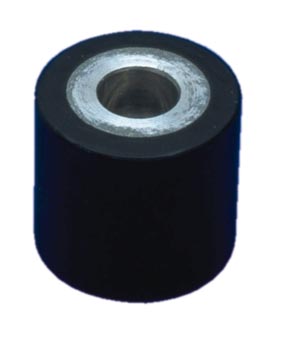

    Very often such tape transport problems are caused by a worn out pinch roller.
    These need replacement after long time use.
    The same was wrong with my JVC HRS8600 I picked up for free because it was "eating tapes".
    Pinch Roller Video

    The_Doman, how did you know it was the Pinch Roller for your VCR?
  14. Member The_Doman's Avatar
    Feb 2004
    Netherlands
    Well it was a bit of a guess ofcourse, but I have seen the same problems on a lot of older VCR's i have had.
    You can easily recognize a worn out pinch roller because it will look shiny and feel polished.
    Cleaning does not help, you need to replace it.
    A worn out pinch roller is one of the most common faults in older used VCR's.
    http://www.videointerchange.com/tips.htm
    Reasons for tapes being "eaten" are varied, but a common cause that warrants discussion, is a defective pinch roller.
    Regardless of the format, manufacturer or machine model, from the very first Quadruplex VTR to the latest MiniDV camcorder, ALL video recorders use a pinch roller which presses up against the tape and forces it into a rotating capstan to pull the tape thru the mechanism,
    Over time (whether the camcorder or vcr has been used or not) the pinch roller begins to deform as part of the normal aging process. As the rubber ages & hardens, it does not do so evenly, resulting in an "out of round" pinch roller. Even the slightest distortion (especially in the small tape formats) results first in tape flutter - and as the problem worsens, is exhibited by tape edge damage, as the tape is skewed into the upper or lower guidepost stops. In severe cases, the tape will be forced out of the guideposts altogether, resulting in severe tape creasing and an inevitable catastrophic jam.
    The rubber pinch roller is a critical tape path component and is a scheduled maintenance item. Of all the mechanical components in a camcorder or vcr, it is usually the very first to need replacement.
    Many camcorders and Vcr's have ended up in landfills due to nothing more than a simple rubber pinch roller in need of replacement. In it's wake, there's usually left behind a long trail of trashed tapes & lost memories.

    anitract -
    Your problem doesn't sound like a pinch roller to me.
    The pinch roller is not engaged during Rewind or Fast Forward.
    If the VCR records, plays, and searches fine, then the pinch roller is not likely to be a problem.
