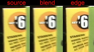

  9. When using the SmartDeinterlace filter in VirtualDub be sure to set the Edge Directed Interpolate option. That will give sharper edges than the default blend.
  10. Originally Posted by jagabo
    Thanks, will try it out now. It seems there are so many different options to do all of this.
