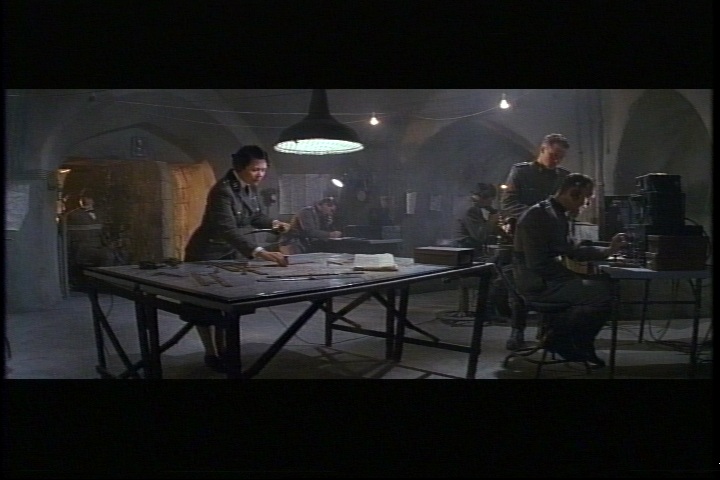

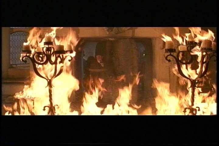

    Some captures from the SVHS version of Days of Thunder (yeah, I know, dumb movie, but it was all I had on hand, and it *is* a prerecorded SVHS.)
    JVC HR-S9911U:
    Sanyo GVR-S950:

    Just a follow-up... I've done quite a few hours of captures using this thing, and it is convincingly better than my 9911U for both VHS and SVHS playback. There is much less noise, despite the lack of any apparent DNR circuit, color looks great, and though I don't believe there is TBC in it, it doesn't seem to skip a beat on playback once bit. Downsides are the manual tracking (though the video level meter helps!) and the fact that it won't play EP/LP tapes... the latter being a big downside. The upside is that I suspect this is a better unit than the various JVC/Panasonic units that are on vogue, but because there is so little information on it, it does not command the price premium.
    If enthusiasts happen to stumble across one of these, I highly recommend it.

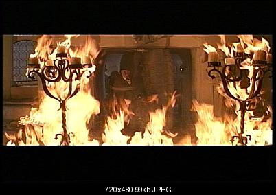

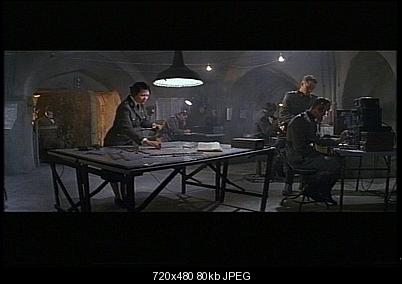

    I've been using this deck to capture a few SVHS tapes (recorded to SVHS from a SVHS Panasonic AG-series camera) and I must say that this deck has been a gem to use. No TBC and still can't get it to play regular VHS EP tapes... well, it'll start then eject after a few seconds. But SP tapes and SVHS is stellar... not so much noise, a steady picture, and what seems like a lot more detail than I get from my JVC 9900-series.
    Definitely recommend it if you want something to experiment with (for SVHS). Here are some captures from an Indy Jones SVHS tape. I've seen some more impressive SVHS captures here and there, to be sure, but not too many that manage this level of detail.

    I see aliasing -- a sure tell-tale sign of artificial sharpening going on.
    Jan 2007
    Must be a pretty good sharpening technique, not a sharpening halo to be found and noise remains in check!
