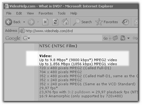

    "9000kbs or lower": to be sure of compliance:
