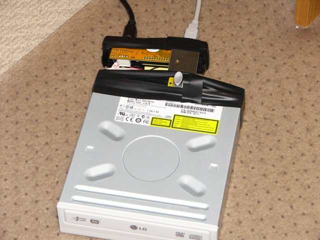

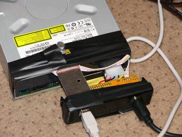

The enclosure I bought is very basic. Shown in first image. I removed both the front and rear endplates and disconnected the power switch assembly from the front plate. I used the metal "rails" as stabilizers and held the whole thing together with electrical tape. I mounted the switch in a convenient location. I but some tape over that blue LED that's WAY too bright. You will have to experiment, since you will likely be using a different 3.5" enclosure.
Ugli, but it works! It's also my first setup to give me 8X writes. Yipeeee!
