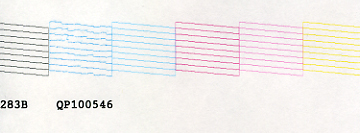

Hey since i got the Canon 4000 and did the mod i really havent used my Epson R200 so its been sitting still for a month or two. No matter how much cleaning i do when i do a pattern test the cyan color prints these lines in the pattern uneven. When i print a regular photo it looks funky and not in a good way. Is my 200 done for good?

I have this happen every now and then I normally will run a Heavy Cleaning with the SSC Utility. Hope this helps.
Link for the Utility is here http://www.ssclg.com/epson.shtml

I also try to use the Epson atleast once a week, For a few photo's or DVD's. That way the jagged lines will not appear. Good Luck
did work i even took the cart out and flushed with windex guess ill have to buy refurb
