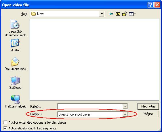

  10. Try DirectShow plugin, and in the Open video file.. window select file type:
    DirectShow input driver as you see in the picture:
    The source of plugin:http://www.virtualdub.org/beta/DShowInputDriver-0.5.zip
    Extract it to the plugins folder.
