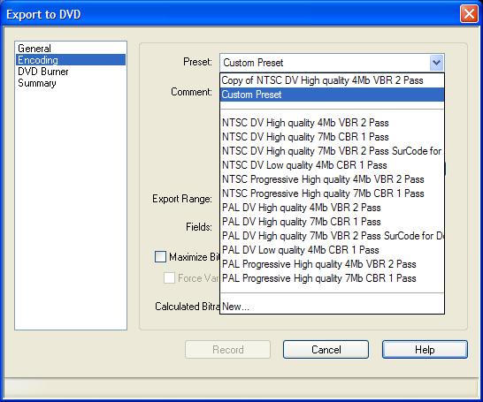

    When I was finished editing my video in Adobe Premiere, I clicked "Export to DVD"
    I was given several options on how I wanted it to be encoded.
    Here are the encoding options:
    I choose the default: "NTSC DV HIGH QUALITY 4MB VBR 2 PASS"
    I then burn the video on to DVD. When it finished, I played it back on my DVD player. The image quality is terrible, much worse than the original video.
    I tried burning it again, using a higher quality encoding process. (9MB/s)
    It still looked like crap when i played it on my DVD player.
    What am I doing wrong? Any help is most welcome. Thankyou

    Try the 7Mb CBR or VBR or better yet make a custom CBR 8.1Mb/s wPCM or 9.5Mb/s with MP2 224Kb/s.
    So many fall for that 4Mb "high quality" setting.
    For DV camcorder material, you want high bitrate and 60-75 min per DVD upper expectation.

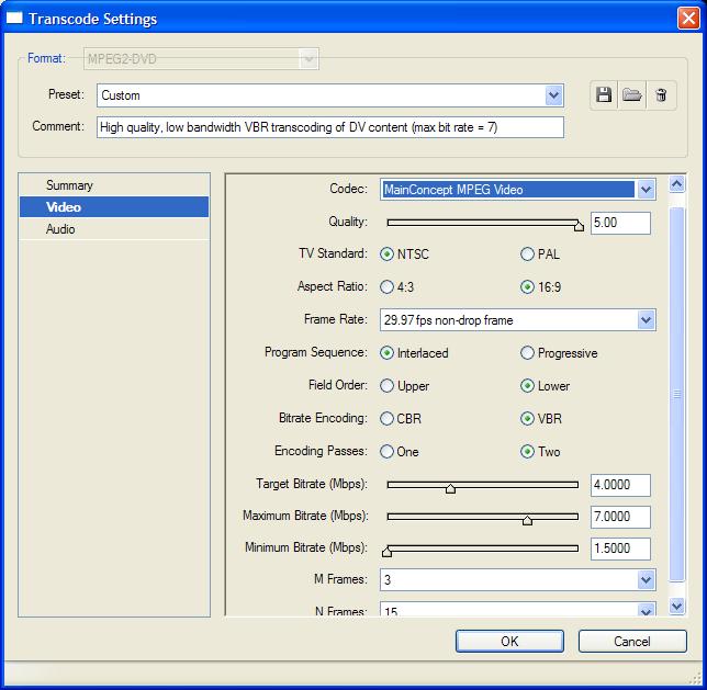

    Here are the settings that I can choose from
    Can you help me pick which ones I should choose?
    Mar 2006
    Canada
    I just noticed something: at the top of this picture:
    It says: MPEG2-DVD. Is that what I want? Its shaded so I cant change it.

    Lets max it at
    CBR
    One Pass
    Target 8200 (if PCM audio), 9500 if MP2 (224Kb/s audio)

  20. Member Cornucopia's Avatar
    Whoopity-do, it says "Max 7mbps"! You should notice the AVERAGE bitrate: 4
    NOT GOOD for home camcorder, interlaced material (especially if it is handheld). Crank it up so that it is something like this:
    • Quality = Max (5?),
      NTSC, 16:9,
      29.97 (drop or non-drop, depending on how you set the camcorder & editing app)
      Interlaced, Lower,
      VBR, 2pass,
      Target = 7.5Mbps (this is what they normally mean with "AVERAGE")
      Max = 9.5Mbps
      Min = 1.5Mbps
      M=3, N=15
    Then set audio to MP2 (16bit, 48kHz, stereo, 192kbps, CBR) or AC3, if you could (similar specs).
    (Boy, nothing about Open/Closed GOPs, Motion precision, Qmatrix #s, etc! Is that all they really give you to work with in PremierePro? Man, I'm glad I got Vegas) Good luck.
    Maybe you could just frameserve. Then you might have more (better!?) choices of encoders.
