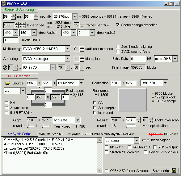

whenever I use FitCD it resizes my movies to full screen. The only way to get assymetrical AddBorders() in the script (and letterboxed movie) is using overscan > 0. Also, my "round to"īs are set to 0, and no block align. Why is it that I cannot get letterboxed parameters for the resize command ? I saw your example generated a AddBorders(0,64,0,64), which is a typical letterbox resizing. This, I cannot get with my FitCD.
thanks for yor attention. -
I have source Round To set to 1, and Crop set to Accurate.
I have Destination Round To varies from movie to movie, as does the overscan. Often OS is set to 0.
I don't remember ever having non-symetrical border numbers. Playing around with it now, I can't force it to give me non-symetrical borders.
Can you post a screen shot ?Read my blog here.
Buddy,
here is an example. It is 656x272 (2.41:1) and if I convert it to DVD, it should be 272*480*(4/3)/656 = 266 pixels height. So, I would write a resize command like :
Lanczos4Resize(720,266).AddBorders(0,106,0,108) for 4:3 or
Lanczos4Resize(720,352).AddBorders(0,64,0,64) for 16:9
FitCD gives me this screen (image FitCD-1). As you can see, no AddBorders commands. If you execute this FitCD code in MPC, you will watch a fullscreen movie.
