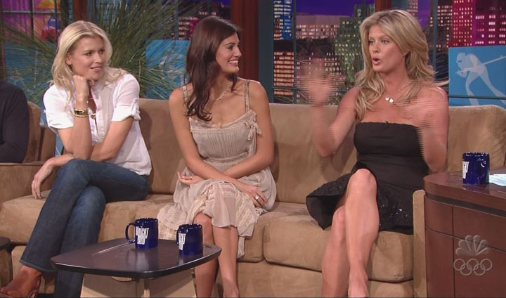

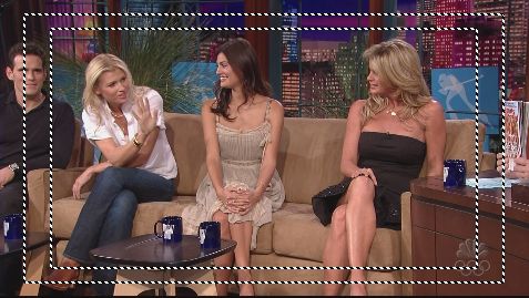

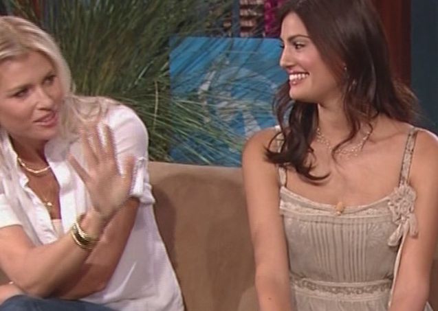

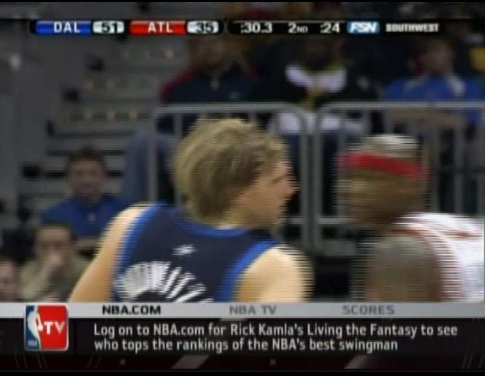

top picture looks crap, botom looks bad, but i know my tv signal doesnt look as bad as the first one, maybe u paused it a a funny moment, plus a basketball game and a talk show are to different a source to compare, i.e fast moving and background crowds, compared to a well designed set with talking people
Umm, I think you don't get it. They were both intended to show how motion is handled in interlace video and neither is crap. It is the way it is. When the picture is in motion you see this as smooth motion. Top picture is 480i, bottom picture is 1080i sized down to about 1/3 width.Originally Posted by slimpickins
If either picture was 24 frame film, you would see jerky motion during playback.
Now, can you explain what you see in those two pictures? Look at the shoulders of the basketball players and the model's hands. (Hint, the computer shows two fields at once). -
Maybe this will help. Top picture is 1x size so you can see the individual 1080i scan lines. You are seeing two fields displayed as a frame. Look at the left model's hand. You see two fields offset by 1/60 sec. Bottom picture shows the full frame.
