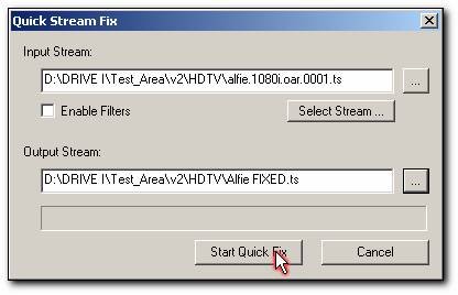

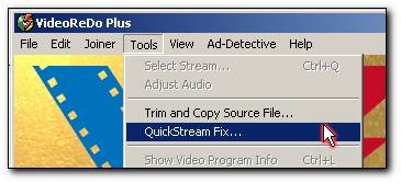

    (Assuming you are talking about HD Transport Streams):
    Grab the latest VideoReDo Plus and use its "Quick StreamFix":

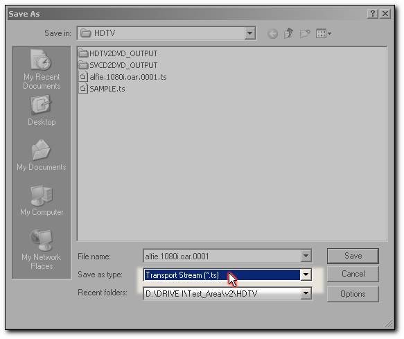

    Make sure you chose Transport Stream in the output dialog:
    Then try the fixed file.
