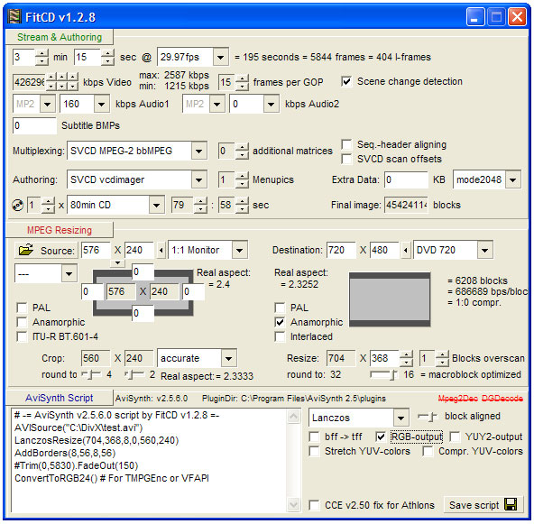

Here is your source in FitCD:
First let me explain how to use FitCD ... it is rather simple. First you need to install the latest version of AviSynth which is pretty much straight forward as it comes with an installer.
FitCD is just a ZIP file and you just extract the ZIP file into a DIRECTORY of your choice and it is "installed". Just click on the FitCD icon. You can even make a desktop shortcut for it and forget where you put it.
After you open FitCD you want to click on SOURCE which is near the left hand side just under where it says, "MPEG RESIZING"
You can then browse to your AVI file and load it up. In my example I created an AVI file called "test.avi" with a resolution of 576x240 to match your AVI file.
After you load the file you will see the resolution next to where it says SOURCE. Here in my example you see it says 576 x 240
Next to that you set the aspect ratio of the original. I've set it to "1:1 Monitor" and that is correct for all MPEG-4 files which includes DivX and XviD.
You will see that there are checkmarks on the left hand side for PAL, ANAMORPHIC and ITU-R BT.604-4
If the source is NTSC you do NOT checkmark PAL. You only checkmark PAL when the source is PAL or has a running time of 25fps (which is PAL)
For MPEG-4 (DivX and XviD etc.) do NOT checkmark ANAMORPHIC.
The ITU-R BT.604-4 option "depends" and it is a "sticky" thing to talk about but in most cases you do NOT want this checkmarked.
Now see were it says, "Crop: .... ACCURATE" ... there are several options in that dropdown box but in most cases it should be set to ACCURATE
The other options like ROUND TO are FitCD default settings and should be left that way.
So now the SOURCE is set up.
The parameters for the DESTINATIOIN are on the RIGHT HAND side.
Since you are making a DVD you want to select 720x480 in the drop down box ... this is the box that in my example says "DVD 720"
PAL should be left unchecked since this is a NTSC source and we are making a NTSC DVD.
Anamorphic is up-to-you. Since the original is widescreen with an aspect ratio of 2.4:1 you can make a ANAMORPHIC DVD or you can make a standard 4:3 WIDESCREEN DVD. In my first example I did NOT checkmark ANAMORPHIC.
For MPEG-4 (DivX and XvidD etc.) you would NOT checkmark INTERLACED since these sources are 99.9% of the time PROGRESSIVE.
You will now notice the option that says RESIZE and in my example it says "704x272" and there is "1" block of OVERSCAN. There are 4 options for OVERSCAN. Option "0" is NO OVERSCAN then there are options "1", "2" and "3" with "1" being the least and "3" being the most COMPENSATION for OVERSCAN. I find that using the "1" or "2" setting is just fine for most televisions. The "3" option is almost always overkill.
In the bottom right hand area make sure the drop down box for RESIZE METHOD says LANCZOS and since you are usig TMPGEnc Plus you should checkmark the RGB-output box. If you were using CCE you would instead checkmark the YUY2-output box.
The script that is created for you is in the lower left of the screen. Just CLICK ON the SAVE SCRIPT icon in the lower right corner and it will save a script that matches your original filename but with the AVS ext.
For instance my file is called "test.avi" so my script will be autonamed "test.avi.avs"
You then simply load the AVS file into TMPGEnc Plus and make sure you have the VIDEO ARRANGE METHOD set to FULL SCREEN. In this scenerio it doesn't matter what you pick for the input aspect ratio although the 4:3 NTSC option would be correct in this case. If you use the WIZARD MODE make sure you change VIDEO ARRANGE METHOD to FULL SCREEN as I think the default for the WIZARD MODE is FULL SCREEN (KEEP ASPECT RATIO).
Now let's go back to FitCD and checkmark the ANAMORPHIC option on the desination side. That's all I have changed in the image below:
Here we see that the video will be resized to 704x368 thus making a 16x9 WS DVD whereas in the original example it was to be resized to 704x272 which would have made a 4:3 WS DVD. In both cases the aspect ratio is almost exactly the same but one is "anamophic enhanced for 16x9 televisions" and one is not.
In the second example, when using TMPGEnc Plus, make sure to select FULL SCREEN again for the VIDEO ARRANGE METHOD. Again it doesn't really make a difference what you set the Source or Input Aspect Ratio as although the "proper" setting would be 16x9 NTSC
FitCD is easy-to-use and allows for more control since you can use OVERSCAN COMPENSATION if you want. Another reason to use it is that Lanczos Resizing is better than what TMPGEnc Plus can do on it's own with it's built-in resizer. Last but not least this is a very simple way to start using AviSynth and AviSynth AVS scripts so you can get your feet wet using this powerfull tool although as you can see there is not much to it as FitCD creates the script for you so really you don't ever have to learn AviSynth if you don't want to.
