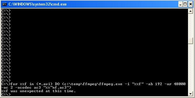

Just tried typing the abovew but got %%f was not expected at this time....sorry but I am command line noob.
Works fine here. Did you copy it exactly? If you are running 98/me then that could be a problem.
still getting same error message: %%f was not expected at this time..Here is a screenshot.
screenshot.jpg -
Thanks so much for your help...its up and running now DOS and Batch....with batch file it should be basically as productive as the GUI. Hope someone else finds this thread useful.
