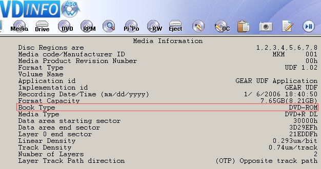

What about booktype bitsetting to dvd rom?

EDIT - I just checked and found that the Fuji 2.4x DVD +R DL I burned was burned as booktype DVD +R DL while the original is coming up as DVD ROM. I will try again with DVD decrypter ISO>READ and then (making sure my booktype is set to DVD ROM) I will try ISO write @ 2.0x with dvd decrypter. The dvd is a couple years old so it should backup.

DVD Decrypter ISO read>
made sure booktype setting for DVD +R DL = DVD ROM
DVD Decrypter ISO write>

Remember kids, if you want your DL dvd's to play on as many set top dvd players as possible, always set booktype to dvd rom. My burned +R DL dvd wouldn't play on the C750 or F85 but the dvd rom booktype iso burn was good.

Remember kids, if you want your DL dvd's to play on as many set top dvd players as possible, always set booktype to dvd rom.No DVD can withstand the power of DVDShrink along with AnyDVD!

Tools>Drive>Change Book Type
Your drive must support changing book type. You can usually only do this for +R and +R DL (maybe +RW too?).
