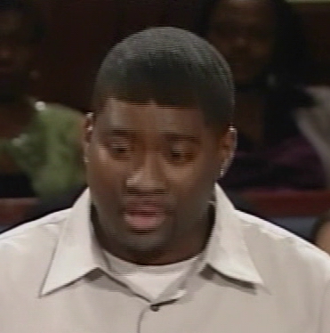

    is it ok to post a 2 sec clip tv capture ?
    i played back in media player classic, first with main concept mpeg decoder, tried all deinterlacing settings, also used cyberlink powerdvd mpeg decoder, same ghosting
    here's frame grab, cut around suject, which was moving his head downwards.

    ok, just found a hauppauge tweak tool, and it does have a tweak for 'temporal filter' it was set at 8 i set it to 0, problem solved.
    http://www.cask-of-amontillado.com/pvr_tweak.html
