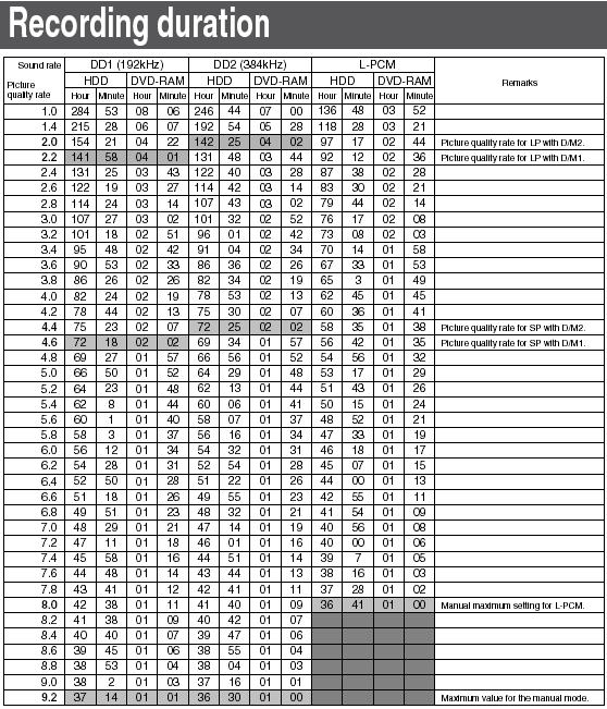

Here is the bitrate adjust chart from the XS34 manual,
Does anyone with this recorder know when it drops from D1 to 1/2 D1? -
