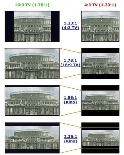

    WIDESCREEN Televisions have an aspect ratio of 16:9 which is basically 1.78:1 so any movie that has a ratio above that will have black on the top and bottom of the movie image.
    Many movies are 1.85:1 so they have a tiny bit of black on the top and bottom but often times you will NOT see the black because even though it is there the TV OVERSCAN "hides" it as there is only a small sliver of black on the top and bottom.
    In case you do not realize this ... all televisions have OVERSCAN which is a term used to explain that a television does NOT display the "extreme" edges of the video image.
    2.35:1 is a lot "wider" than 1.78:1 so yes you will see some black above and below the movie image.
    Another popular movie ratio is 1.66:1 and sometimes that will be made anamorphic but in those cases there will be a lot of black on the left and right of the movie image but again sometimes you see it and sometimes you will not because of TV OVERSCAN. Every TV is different with some showing more of the extreme edges than others but none show the image 100%
    Also to clarify if a movie is "anamorphic widescreen" that just means that it was encoded to take advantage of the extra "real estate" one gets with a 16:9 WS TV but the ratio can be 1.66:1 or 1.85:1 or 2.35:1 etc. yet still be "anamorphic widescreen" or sometimes the DVD will say, "enhanced for 16x9 televisions"
    So in short an "anamorphic widescreen" movie is not automatically have a ratio of 16:9 or 1.78:1

    well i rephrase my question, Is a 2.35:1 material on anamorphic dvd, incoded within a 1.78:1 frame or 2.35:1 frame?
    DVD only supports two aspect ratios: 4:3 and 16:9. Anamorphic movies that are wider than 16:9 (1.78:1) still have some black borders. But not as much as when encoded as non-anamorphic 4:3.
    A non anamorphic 2.35:1 DVD will have a ~720x272 picture within a 720x480 frame. Anamorphically it will have ~720x364 picture within a 720x480 frame.

    A movie with an aspect ratio of 2.35:1 can be 16x9 anamorphic widescreen but there are still black bars above and below the image because when you "fit" a 2.35:1 image inside a 16x9 space (and again 16x9 is roughly 1.78:1) then you have dead space on the top and bottom of the image if it is to fit from right to left.
    Pehaps later tonight or tomorrow I will post some actual movie pics from various DVD discs with various aspect ratio's so you can "see" the difference but for now that website link provided by Baldrick should help you to understand.

    a picture is worth a thousand words

    Of course I understand that 2.35 wouldn't fit 1.78 tv screen without black bars, but what i was trying to find out has in fact been answered by the linky posted by balkdrik quote from it "So, 20:9 anamorphic probably won't happen for DVD. However, a new, higher-resolution DVD, called DVD-HD, is due around 2003, perhaps earlier. DVD-HD discs will be incompatible with today's DVD players, though DVD-HD players will play today's DVDs. Since DVD-HD will require new players anyway, that would be a great opportunity to add 20:9 anamorphic to the standard. Who knows, maybe someday that might even lead to 20:9 television sets. Let's hope the industry players decide to make DVD-HD 20:9 anamorphic!"
