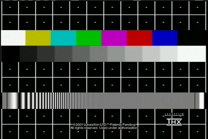

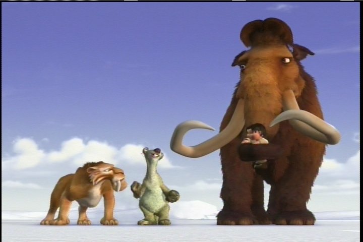

Here is an image made with the GX315 with an IRE = 7.5 source.

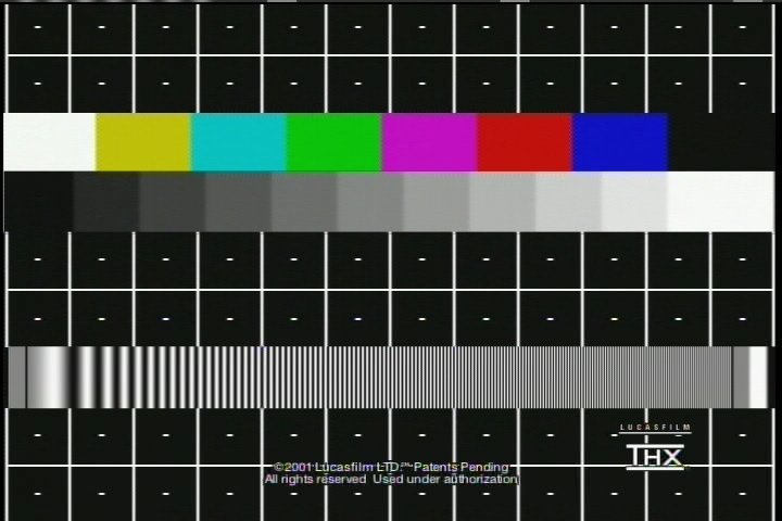

and with the source set for IRE = 0,
Gshelley61, I tried making a copy using the RDR-GX315 and it looked fine. I didn't see any difference in the black level (at least as far as my eyes can see). I'm not saying your wrong, but did you find a significant difference in the copy?

There is not much black in the images I posted above. Here are two that show the difference in black level better,
First the source is IRE = 7.5
Now the source is IRE = 0
