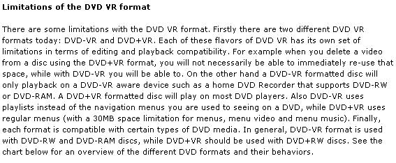

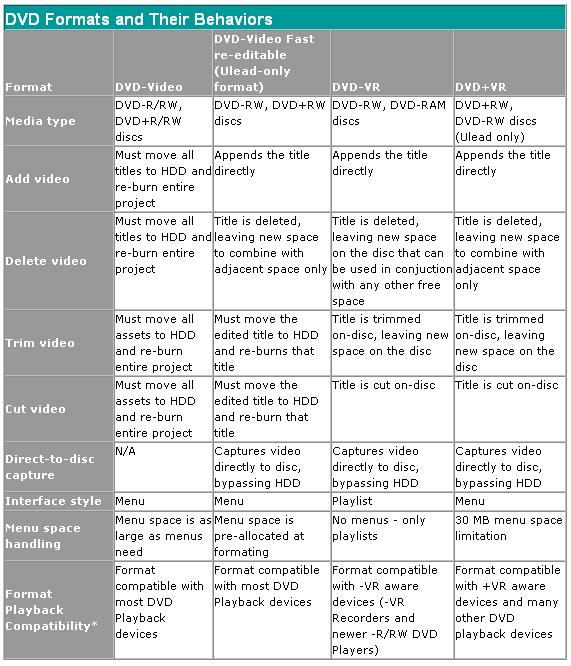

  5. Yes, I was aware of the differences. The big difference to me is that +VR mode does not require finalizing in many instances. I have a borrowed Sony GX315 and the manual says that it still may require finalizing in some cases. +VR is certainly more compatible than -VR. Here is a some additional info,

    trhouse, some of that info on the grid of info is totally bogus. For example, edits made on DVD+VR do NOT make more space available, it just "hides" it, and even then, this hiding effect is known to corrupt IFOs and not work on any player other than the recorder.
    There's more too, but I don't have time to get into it.
  9. Lordsmurf, you are correct. I read the text above the table and did not look at the table closely enough to realize the that the text and table conflict.
    Here is the text from directly above the box,
    For those interested, here is a link to the full text from the Ulead Learning Center.
