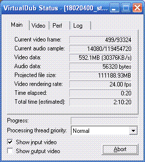

I have installed the codec, opened it in virtualdub and still no joy. The image is what i get when i open the status window, there seems to be "some" data there in the audio, but i cant get it to play. Also, in the "Perf" panel, it says that audio streaming is disabled. But it isnt.
[/img]
