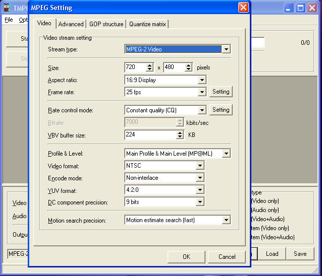

I use DVD Decrypter in IFO mode to get the audio & video into two seperate full length files, then TMPGEnc to change the vid to 720X480 leaving the fps at 25, using the deinterlacing filters as needed, then use DGPulldown to change the framerate to 29.97, never touching the audio.
Then i load the video & audio into DVD-lab PRO, TDA ect.
You have to use the unlock template in TMPGEnc though to be able to set the res. for NTSC and use 25fps. I set mine up the most common way i do them then saved it as a template so i don't have to readjust everything each time i do it.
By just changing the resolution but leaving the FPS the same keeps the audio & video in synch. DGPulldown does not actually change the fps from 25 to 29.97, it just changes the ID flags to say it is.

Look's the same as mine except for where it say's "video format".
That's why i set mine up with the unlock template so i change anything i need to.
That's what you want, because you are just converting the video to video not using the audio.Originally Posted by hech54 -
I want to keep it at PAL format don't I?....then run it through DGPulldown?
No,. you want to make it NTSC without changing the framerate, then using DGPulldown to change the id flags from 25 to 29.97.Originally Posted by hech54
By not changing the frame rate you won't get out of synch audio. -

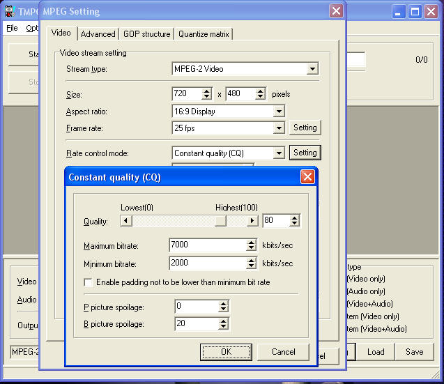

Well the encoded size will depend on the bitrate set and the quality.Originally Posted by hech54
You could do it at full bitrate and then use shrink to shrink it down and see how it look's, i've never done it that way before as i like to fiddle with the settings to get the movie to one disc with as little encoding/transcoding as possible.
I have played and fiddled with settings prob. for 100's of hours testing diff. settings, bitrates/quality ect.
This is just an example of when i put 4-45 minute episodes to one dvdr as i have used much higher bitrates & quality settings, each time i may have to run 2 trys to get it to fit depending on the movie ect. but that don't bother me as i usually just set these things to run when i go to bed one or all of my systems.
I guess as long as the quality difference will not suffer too much....either method would be fine for me. I'll let TMPGEnc Plus set it to DVD5 size as this will be a one-time shot for me for the most part. I have one friend in America that cannot play anything PAL and cannot afford a new player so I want to do her a favor....although almost two hours of home movies might be a bit much fer her...
