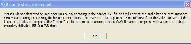

can anyone tell me why i get this when loading .avi movies into Virtualdub

VirtualDub does not support VBR audio in AVI. It will re-write some headers so the VBR stream will be read as CBR, but this will usually cause desynch (as the warning indicates). There are several ways of dealing with this:
1. Ignore the message and do a remux with AVIMux GUI after you processed the file with VirtualDub. AMG does handle VBR audio and writes appropriate headers.
2. Use VirtualDubMod, and answer "no" when asked to re-write the headers.
3. Decompress the stream to an uncompressed WAV file and compress again using VirtualDub. This will introduce quality loss.

ok i can see how to extract audio from movie in 1st web page u pasted using virtualdubmod but how do i put this back into movie using virtualdub

EDIT: To put the modified audio back in with VDM, select 'Add' in the stream list. Click on the new audio, then 'Move up'. Click on the old audio, then 'Delete'. This won't damage the original video unless you save it under the same name.
If you want to convert the WAV back to MP3, select 'Full Processing', then 'Compression'. Select MP3 and a audio setting similar to your original settings. Or just use 48kBit/s. 24.000 Hz Stereo 6KB/s.
Now for Video, select 'Direct stream copy' and 'Save As' with a new title and you have muxed the audio back with the video in a new file.
VBR is fairly common and you may find yourself needing to do this often.
You can also just use the original video, along with the separate WAV and most MPEG encoders can accept them this way.
