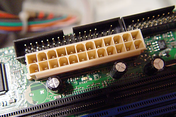

I know what you're saying but if I plug a 20 pin connector into it, there are 4 empty slots left (its a 24).
His name was MackemX
What kind of a man are you? The guy is unconscious in a coma and you don't have the guts to kiss his girlfriend? -
This is what the main connector looks like:

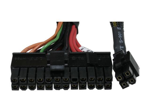

My suggestion would be to get a new computer case because that would solve your problems. Antec has many cases to choose from which I've used with all of the computers I've built/build. Antec cases come with a power supply with the newer 24 pin connector which can be converted to a 20 pin by just using a screwdriver to remove the extra 4 pin. Antec power supplies also have a separate 4 pin connector that you would use on a mobo that has the 4 pin connection.Originally Posted by Conquest10
So if your mobo has a 20 pin connector then it would need a power supply with a 20 pin connector. If it's a power supply that has a 24 pin connector just remove the extra 4 pin . But if it also needs the 4 pin connector then you would use the separate 4 pin connector that comes from the power supply. Not the extra 4 pin that you removed from 24 pin connector.
My two ASUS mobos for my Pentium 4 computers use the separate 4 pin connector along with the standard 20 pin connector that is connected to the mobo. I removed the extra 4 pin connector because my mobos have the 20 pin. Hope you're not confused. Just my 2 cents!

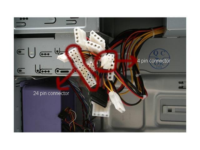

My motherboard actually has a 24 pin connector as well as a seperate 4 pin connector. What is this called? This sucks looking up cases and not knowing whether or not it'll work. So far I have only found this one with a picture of a 24 and 4 pin connections.
http://www.newegg.com/Product/Product.asp?Item=N82E16811129166

I've built pc's using the above case. All of ANTEC's power supplies come with the 24 pin connector so your mobo is fine with that. The power supplies also come with a SEPARATE 4 PIN connector that you will plug into your mobo where the 4 pin connector is. -
