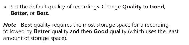

    Here is what LG says about their new model 519,
    It took a call to customer support to just to find out that Good is about 160 hours on the 160 GB hdd, Better is 100 hours, and Best is 70 hours.

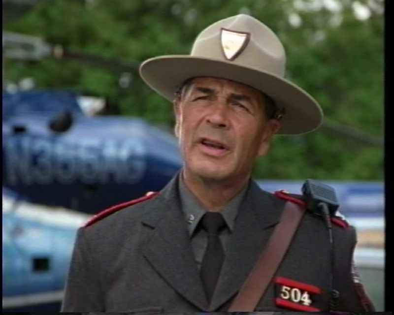

  27. Member jeffshead's Avatar
    Feb 2004
    Originally Posted by jeffshead
    Ok guys.
    I'm going to BestBuy and purchase the Toshiba D-R4 tonight. I will play around with it and post some comparisons in a day or two.
    Anyone care to rate these caps 1-5?
    I will post which machine made which cap after I get some feedback.
    A
    B
    C
    D
    E
  28. Member FulciLives's Avatar
    May 2003
    Pittsburgh, PA in the USA
    B looks best to me in that it has the most detail BUT not too much noise.
    I really have a hard time trying to pick the one that looks the worst to me.
    I can tell A is the JVC or so I think.
    C and D look very similiar to me ... so much so I can't really say which is which.
    E looks good ... I'd rate it 2nd to the B picture.
    So for me it is in this order:
    1.) B
    2.) E
    3.) A
    4.) C + D = TIE
    E looks good but is overly saturated colorwise
    A looks good but is too bright
    C + D are a bit too blury
    B really looks best to my eyes detail wise and colorwise.

    I tried the Toshiba DR4 vs my JVC DRM70S which apparantly is only available in Canada. The JVC wins. Ive tried many tests and running them simutaniously on my tv, the results are undeniable.
    I posted screen caps in another thread to show why. Nothing I could do, would make the Toshiba produce a better image than the JVC. The only advantage the Toshiba had was its 3 hour mode. But then I think my JVC 4 hour mode does a better job with the exception of a tiny bit of blocking, or whatever you guys call it, around the cars in the picture. The picture on the JVC in 4 hmode seemed sharper than the Toshiba in 3 hour mode.
    Whatever filters or TBC or you call can call it whatever you like, they work better in the JVC than anything else ive tried, including the DRM100s.
