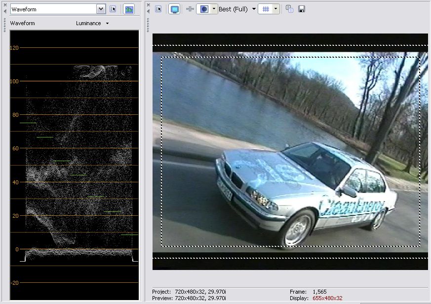

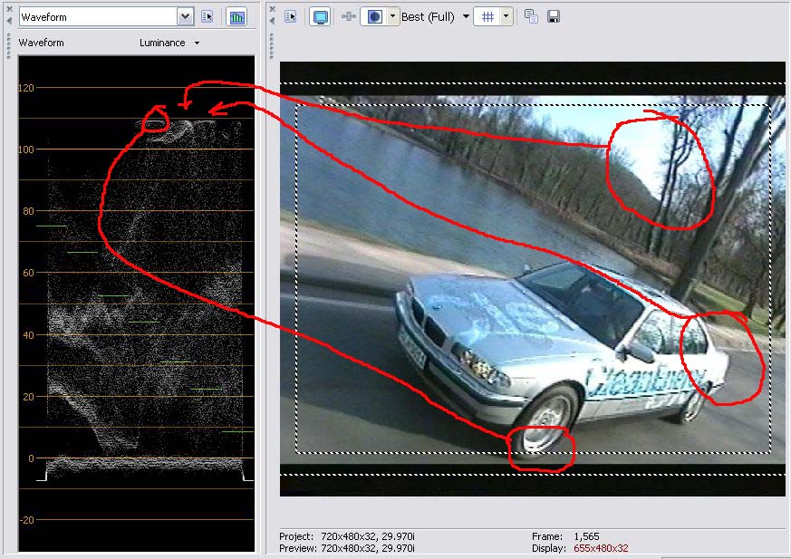

Looking at your pictures, it appears both have ok black levels but the whites are clipped at level 255 causing the harsh highlights. White level should be at level 235 (100IRE) with the area between 235 and 255 reserved for transient overshoots.Originally Posted by SerbianBoss
This could be due the tape being recorded that way or the VCR is outputting at too high a video level or it could be happening after capture.
If you post a DV format frame (just after capture). We could see where this is happening.
Once the levels are fixed, we can look at noise before and after encoding. -

The ADVC-100 doesn't have gain adjustments. It looks like your VCR is outputting at too high a white level (video gain), causing the ADVC to saturate at digital level 255 (108%). Blacks are a bit low. If you are using PAL, the IRE switch should be in the " 0 IRE" position.
Otherwise this picture looks good to me for VHS. Others have more experience with VHS and the ADVC. It will look much better played to a tv. We are looking here at a progressive representation of an interlaced stream.
