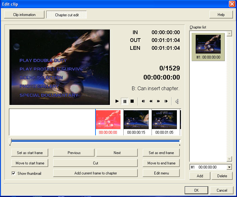

If you select the second file & go to "Chapter Cut Edit" you will see the chapter point at the very start of the second file where it connects to the first file.

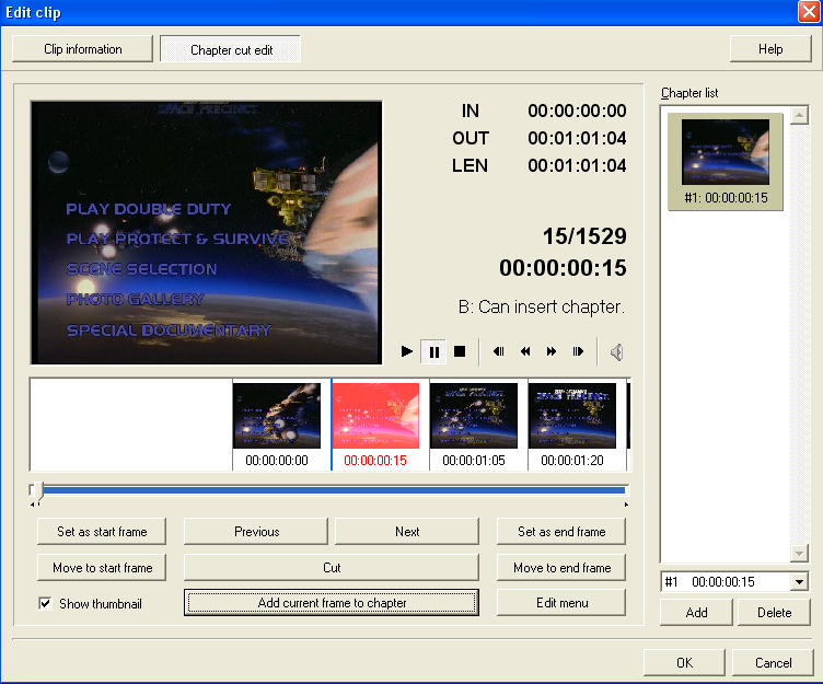

Delete this chapter point and add it at the next frame or where ever yuo want to & now when you play it back there should be no pause between the first vid/file & the second one.
No true, at least in my experience. The solution offered by Noahtuck works (at least for me). For this pause goes away if move by one frame (forward or backwards) or delete the first chapter point for the second, third, etc. clip added to a given track.Originally Posted by The_Doman
Well I know for sure that moving the chapter point one frame (forwards or backwards) works. I think deleting the frame works too but I need to verify that. -

How do I delete the chapter point and start a new one? Is it just move the chapter point over one frame on the second file, then click on the "Set as Start Frame" button, or "Add current frame to Chapter" button, or something else...
