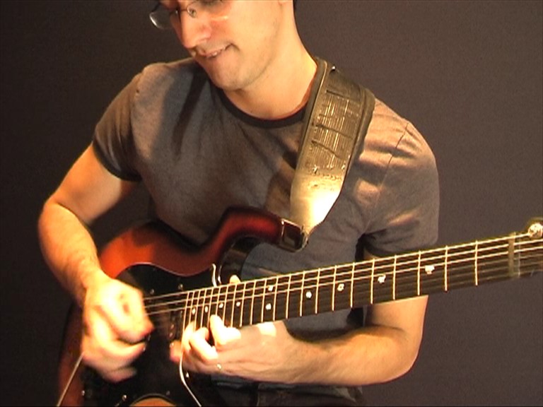

  13. Sorry for my late reply, I have been away during the day.
    Thank you very much for your advice, I will go through all the links and suggestions.
    You are also right I should definately spend more time learning about shooting film! Especially now that I will be charging fo the vids.
    This is one of many attempts to get the right light and sharpness with my new cam.
    Now when I do a close-up it works better, although it isn't very practical as the whole fretboard needs to be visible:
    /Kris

    Looking at those shots, nowhere near enough light and what there is is way too close to the subject. The auto exposure on the camcorder is winding the gain up as far as it will go to get something like the correct exposure. The result is very high contrast. This is what is causing the fingertips to burn out. The fretboard isn't in focus along it's length because the depth of focus is very small. This is caused by the lens aperture being very large, also as a result of not enough light.
    You want much more light (I wouldn't tackle something like that with less than a kilowatt), diffused and placed further away from the subject.
    Incidentally, I have a Sony TR8000E (as well as a pair of VX1000E's) and will agree that the low light performance is superb. 3 CCDs may give better colour rendition but one big one needs a lot less light than 3 little ones!

    Not too bad but lacks some definition. You probably use auto exposure and that is an average of the frame or measuring field of the camera. To get better results you would need to experiment with not only object (guitar, hands) ligting but also ambient/room lighting (bit dark...). Setting camera to manual exposure/gain and focus should give more refined look. You may take a digital picture with a still camera and then manipulate camcorder settings, lights etc. to arrive at the combination that is close to it. Compare the output, color fidelity of both still cam and camcorder.
    And again, lights and camcorder are too close. You probably have some DVD's or VHS tapes like HotLicks. This would be a good starting point to explore diffrent setup options (lighting, shooting distance and angle (shooting from the angle you chose is not the best for left hand although I understand you want to cover both hands), zoom etc.).

    As others have been pointing out, your new camcorder has three relatively small CCDs which require more light than does one large CCD, so your lighting is too low. If you still have the sony, shoot some footage outside on a bright day and you will see the difference.
    To get good shots you need more lights, and you should try to diffuse the light a little more than in your example shots. I would recommend lighting he background as well, to create more contrast with the guitar neck.
    Since you are doing close-ups like this, and you need good sharp images, I would recommend getting a wide converter. Check pana3ccduser.com for a lot of reviews of wide converters. This should give you better depth of field as well.
    Somewhat simplyfied, but... Do note that a 3CCD camcorder will not necessarily give sharper images, that is not why you have 3 CCDs. Everything staying the same, 3 CCDs will give you better color representation only. To me that is hugely important since I shoot different situations than you do. Going by your subject matter, it wouldn't really matter if your stuff was color or black and white, so for these particular shots 3 CCDs are not going to give you a huge advantage over 1 CCD. I assume you will use the camcorder for other things as well, and then it will matter.

    Let's not get carried away, the GS400 can produce good pictures with good light, but comes nowhere near PD-150 performance in contrasty light (the gamma knee curve* kicks in with the PD-150 compressing highlights) and in low light (1/3" CCDs and huge fast lens).
    Shooting and lighting for TV is fundamentally about contrast control. You need to keep the interesting elements of your scene within the severe contrast limits of video. If you are using consumer gear, the job gets tougher because of noise in the blacks and the lack of automatic highlight control.
    The advice given to light the background (not backlight) is a key to controlling contrast to the video limits. You are raising the reference black level by lighting the background. You are setting the zero IRE point. Key and fill lighting are then relative to this black and control the subject's contrast within the camera's contrast range.
    Your pictures above could also benefit from a Back (highlight) from above. This gives edge definition between the forground subject (shirt and guatar neck) and the background. (see http://www.3drender.com/light/3point.html)
    This shows traditional 3 point setup where the fill lights the background and sets subject black levels. Additional background lighting may be needed for larger sets to control black level.
    * higher end camcorders have strategies for controlling highlights and therefore overall contrast.
    See Gamma heading in this link http://www.adamwilt.com/24p/
    Since consumer camera's have primitive highlight control, you need to be better at lighting (more diffused ) to contol highlight saturation (>100IRE overshoots).
