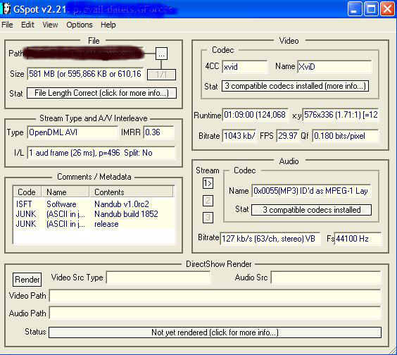

Many types of AVI. AVI is just a container name. It can be Xvid or Quicktime or DV or others. The audio format is similar. Common ones are MP3 or AC3 or less common, ogg vorbis. There are many more
Drop your video into Gspot, it will tell you the codecs used for the video and audio and those are what is important, not the video type. Post the screenshot here. Blank out the title if you like.

i am trying to enhance video and also audio i was told to send snap of movie

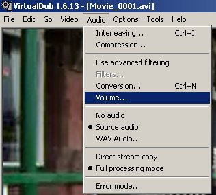

I'm not sure which version of VD you are using, but in general: Select 'Full Processing' under 'Audio' and a volume control selection will come up. Adjust the volume here, and then in 'Compression', select a MP3 compression setting that is similar to what the original is. In Video, select 'Direct Stream Copy' and save the old video with the new audio.

I am using virtualdub v1.6.13 and nothing happens when i do the above no volume control selection pops upI'm not sure which version of VD you are using, but in general: Select 'Full Processing' under 'Audio' and a volume control selection will come up
Something might be amiss with your copy of Virtualdub.
Nevertheless, you may not want to do it that way. It will RE-encode your audio (or just decode it to WAV = larger size). That's why I suggested what I did, NO RE-ENCODING.
Scott -
dam i must be losing it found volume now yes its as you said unghosted thanks all
