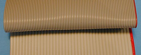

  6. Some drives have issues with cable select settings. If you have 2 optical drives on the secondary ide - just set one to master and the other to slave. Any Pioneer I've ever seen could care less if it was master or slave. I have a DVR108 running in a Dell 8200 as a secondary slave. Your hard drive(s) are probably on primary channel - just leave them alone. The key is - never mix cable select with any other setting on that channel.
    Picture of cable difference:
    Both have 40 pins - but the top one has 80 wires instead of the 40 wire in the bottom example. Hope that makes sense. Good luck.

  8. OneSickPup, thanks for the pic. I'll check what I have, and upgrade, if necessary.
