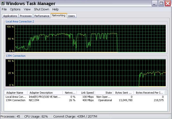

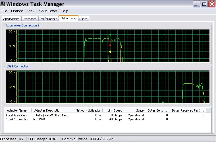

  16. Member edDV's Avatar
    Mar 2004
    Northern California, USA
    FWIW:
    I have a IEEE-1394 connection running point to point. I don't recall how I set it up.
    A large file transfer seems to peak at a sustained rate of ~60Mb/s (60%) on the 100Base-T link and at ~100Mb/s (26%) on the IEEE-1394 link. At least the IEEE-1394 link transfers twice as fast as through the 100Base-T switch.
    I plugged in the IEEE-1394 cable without rebooting. To wake the connection up, I temporarily disconnected the Ethernet switch and then made a file copy to the other machine. XP networking then used the IEEE-1394 link. This machine has XP pro, the other has XP home.

  18. Member edDV's Avatar
    Mar 2004
    It behaves like any other network connection.
    drive is addressed as \\compname\drivename
    I'd like to find out how to get the IEEE-1394 link utilization higher than 26%.
