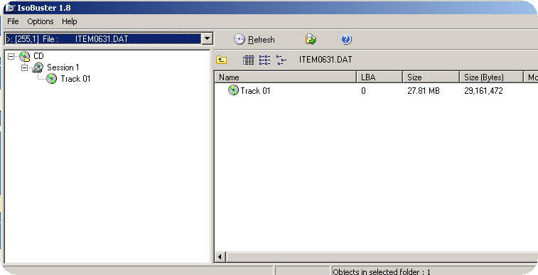

    I have a CD of loads of images made up as a slide show. I can play it OK, but want to extract the images from the CD. This seems impossible to do. This is the view using Isobuster. Is there software that can help me? The CD is from relatives overseas and I have no idea what program was used to make the slide show.

  8. Member Cornucopia's Avatar
    Hold on, that may or may not be a VCD. That ISOBuster screengrab is VERY inconclusive. Sounds like it can't understand the disc type that well--which is very unusual for ISOBuster.
    If you actually had a VCD, it should have the usual MPEGAV folder, VCD folder, SEGMENT folder, etc. And it should be 2 tracks (although it's possible that all the assets are SEGMENTS).
    Do a Sector view of LBA 16 (that's the Primary Volume Descriptor). What's it say? Does it have the NAME of the disc there?
    Then, do a Sector view of LBA 150 (that's where INFO.VCD file is supposed to always be). What's it say?
    If these aren't following standard expectations for VCD, maybe you don't have a VCD.
    You said you "successfully played/showed the pictures". How? Did you use a settop, or the computer, or both?

    Thanks Cornucopia, in the end I did it just using V-Dub Mod. there were 317 images and they all came out looking good. This was a result of you mentioning the "save image" feature in V-dub. Thanks for your help. Next time you are in OZ I'll buy you a beer.
