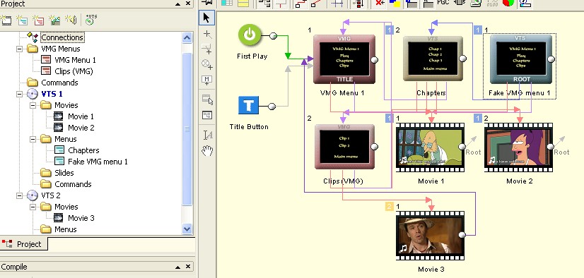

My project is a main video (4:3) and two short clips (a 4:3 and a 16:9)
The initial menu should have 3 links: "Play," "Chapters," and "Clips."
The different aspect ratios require using VMG menus, but I'm having problems:
The compiled DVD works, but after it's finished playing, it returns to the chapter menu. The menu button on the remote also goes to the chapter menu. I want these to go to the main menu, which is "VMG Menu 1".
What am I doing wrong?
The current structure is:
An initial VMG menu
"Play" links to the main video
"Chapters" links to a VTS menu
"Clips" links to a VMG menu which contains links to each clip
Take a look at my Connections window in DVD-Lab Pro if that helps.

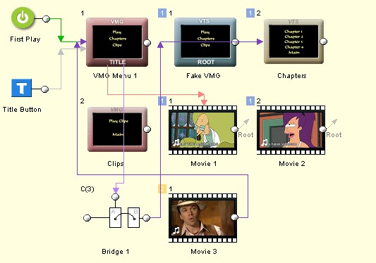

This should work (I just played a little with DLP, haven't actually compiled the DVD):
Just created another VTS1 menu that is an exact copy of your VMG1 menu. You cannot define a VMG menu as your root menu, but you can define this fake VMG menu as your root menu ... no one will be able to notice the difference.

True, it won't work. I propably did the linking in different order than you did and didn't get any error message as I didn't try to compile the project ... There's a simple workaround, though
1) Open the connections window, right click->add->bridge
2) Open your original VMG menu and link "Chapters" to bridge1 you've just created
3) Open connections window again and draw a connection from bridge1 to your chapters menu
I've done this sort of tweaking a few times, but I have to admit sometimes the first "logical" solution doesn't work ... again this should work but unfortunately I don't have the time to test it right now. This time I'll save the project so I don't have to recreate it from scratch if you still need help with it. I'll include another screenshot of the connections with the added bridge, but most of the other connections are not added yet into my project ... should be easier to see the point this way. Please let me know if you managed to get the behaviour you were looking for ...
Roope
