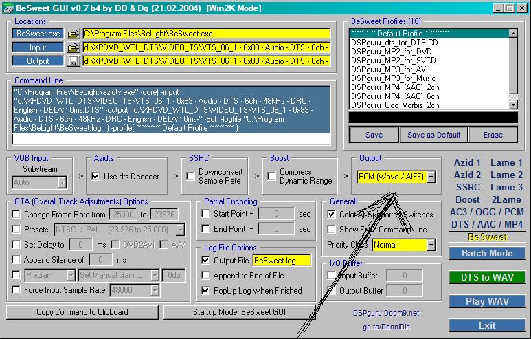

  9. OK, it outputted an MP3 stereo file. Ideally I wanted a WAV file (hence my topic), is there a way to output a WAV and not a compressed MP3 file? The upper frequencies really suffered.
  10. Член BJ_M's Avatar
    Jul 2002
    Canada
    you have to select what type of output you want in the drop down box

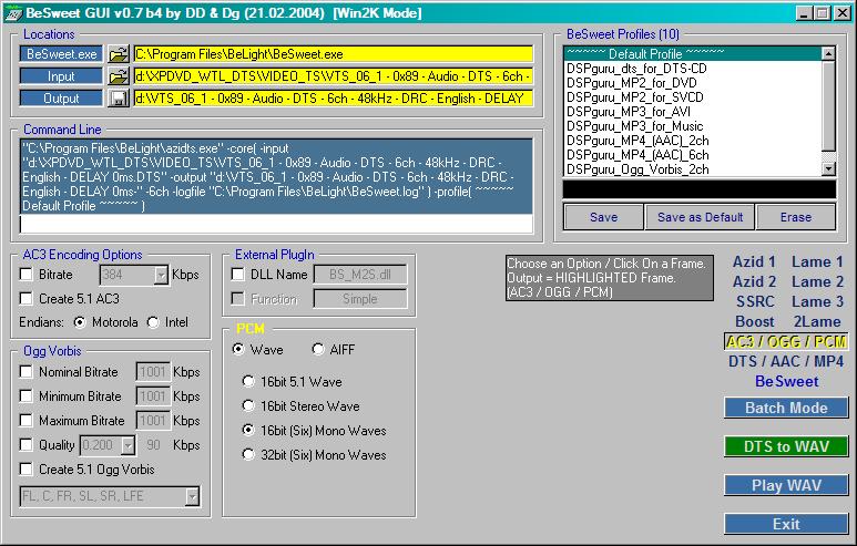

  11. Член BJ_M's Avatar
    Jul 2002
    Canada
    also on the tab i show here -- make sure the PCM options are for 6 mono files
  12. Ah right, cheers man. I was doing it all via the DTS/AAC/MP4 tab
