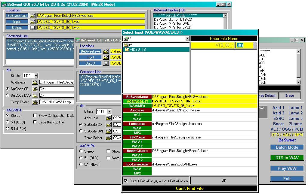

  12. Am I in the right place? If so, it only lets me use AC3 as the input type.
  13. Член BJ_M's Avatar
    Jul 2002
    Canada
    here is a pic

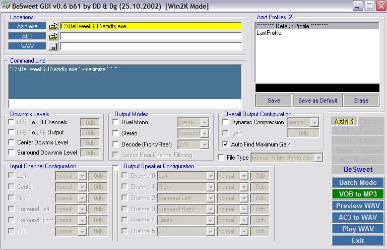

  14. Hmm I dont have the DTS option on the right, as u can see.
  15. Член BJ_M's Avatar
    Jul 2002
    Canada
    another pic
  16. Член BJ_M's Avatar
    Jul 2002
    Canada
    also -- you are using a really old version of besweet - is most of your problem i just noticed

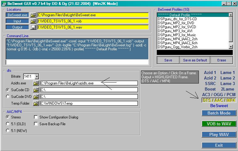

  18. OK, still not showing up on the right side. The aziddts exe is in the folder, but not showing on right pane.
    The Winamp plugin also appears to be a text file

  20. There is no DTS option to choose and the there is no DTS decoder option on the right pane
  21. Член BJ_M's Avatar
    Jul 2002
    Canada
    post a pic - you must be using wrong version of something
  22. I got the latest version from the website. And it still looks like this:
  23. Член BJ_M's Avatar
    Jul 2002
    Canada
    that is the same version you had before

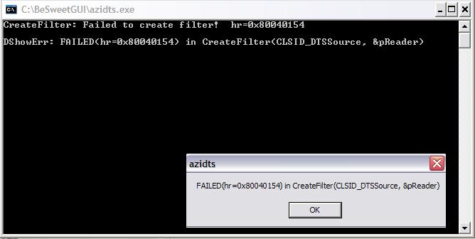

  26. OK, now this happens:
  27. Член BJ_M's Avatar
    Jul 2002
    Canada
    u dont have a dts codec installed as i mentioned a few posts back ...
    install windvd or powerdvd w/ dts
