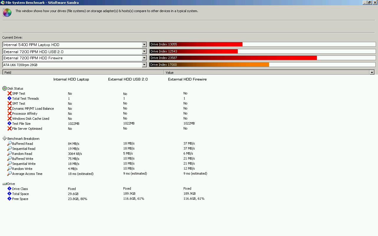

Firewire is much faster. It's not even close. Here's a benchmark test done with my Laptop HDD vs External HDD in USB2.0 and Firewire conection:

Dipstick's link
matches my experience with USB2 and Firewire external drives. The same hard drive on a ATA-133 EIDE will be much faster than either.
Typ WD ATA-133 7200 RPM hard drive for sustained transfer:
USB2 case: 10-18 MB/s
IEEE-1394 case: 20-35MB/s
EIDE/SATA: 35-55 MB/s (a Raptor may get 50-85MB/s)
Also USB2 has higher CPU activity. But none of this matters for a DVD Writer. It will go equally fast for any of the above.Recommends: Kiva.org - Loans that change lives.

Let's summarize what we know so far from above. This is my take.
1. USB2 is always more CPU intensive than IEEE-1394.
2. Using hard drive performance as a reference, IEEE-1394 transfers between 1-2x faster than USB2 in the real world.
USB2: 10-18MB/s HDD sustained transfer performance
IEEE-1394: 12-38MB/s HDD sustained transfer performance
PATA/SATA: 38-55MB/s (55-88MB/s SATA w/WD Raptor)
3. DVD Writers can be assumed to perform in a similar way to HDD.
4. USB2 is more widely supported and has fewer system issues so is more likely to work at the above rates on a random computer. IEEE-1394 needs to be tested and may require disconnection of other IEEE-1394 devices.
Are the above assumptions agreed? What is left out?Recommends: Kiva.org - Loans that change lives.
